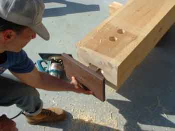

There I saw a different type of post to foundation connection.
Here is a shot of the post base with a steel plate:
(The router in the background was used to chamfer this slot to allow room for the weld at the base of the bar. You can see this chamfer around the slot).
This one inch thick plate has a bar welded to the top that is inserted into a slot cut into the bottom of the post. They put a piece of self sticking roofing material between the steel and the post bottom to prevent any moisture from wicking up into the post bottom from the steel or concrete below. Then the steel base plate was bolted to the post using one inch bolts through holes drilled in the sides:
To locate the spot for the bolt holes in the steel center bar a special punch was made and used to mark the center bar. Then the holes were drilled threw the center bar on site.
When the frame is standing these post base plates will sit on another plate this has been set into the concrete slab floor.
This floor plate has a stirrup on the bottom that was attached to re-bar in the concrete below. Once all the post are aligned the base plate will be welded to the floor plate.

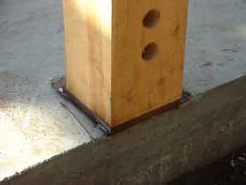

Saturday morning when I returned to the site, four of the six bents had been raised and here is two pictures of the post base plate tack welded to the floor plate:
And a side view:
Unfortunately I didn't see the timber framer with the chain saw jig used to cut the slot, so I don't have any more pictures of it.
