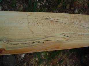

Anyway, on topic.... just a decade late responding  :D.... Best that ever happened to me was a guy has me in pulling logs and sawing for him a couple of years ago and we pulled a big old Grey Satinash that had been felled across a creek ( was off the ground for the middle 40' or so) by the last loggers in there.
Sooo... I hook the dozer on, cut two 15' lengths out and haul one up with the D5 scratching for traction with the weight, dig a hole and roll them in ( seriously big logs), put the Lucas over the top and start hacking away. Cut down aways, pull the log out the hole and finish it... Go get the other half and do it again. 140 lengths of 2x6 x 15'out of those two pieces, plus some shorts and a few 4's and 5's. Ain't nothing like big rainforest trees for flat out production if you got the gear.
The last loggers had been there in. 1969!
