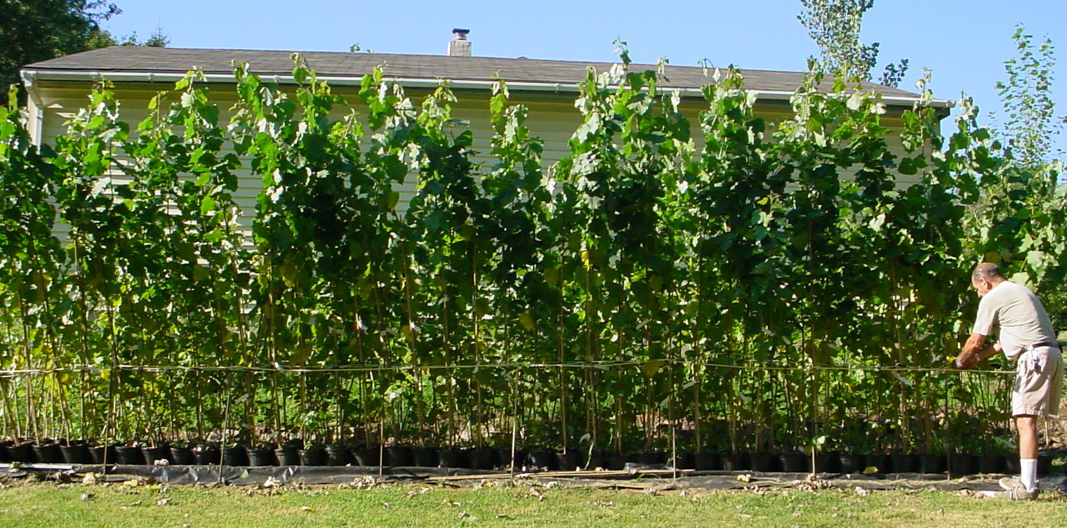

Ron, yes, I did look at Pawlonia when I was researching fast growing trees. I'm in growing region 5b, or 6a at best, and about 2500 feet above sea level. I'm also in a rain shadow of the Alleghany front (crest of the Appalachian Mountain Range) and this region only gets about 25 inches of precip each year. The norm in the surrounding area is about 45 inches, and on the west side of the Alleghanies its as high as 55 inches (big timber grows over there).
I started growing some Pawlonia in pots this year from seed I ordered. I also started spotting them out in the wild after recognizing their purple flowers that bloom in the spring a couple weeks before their foliage begins to grow. All in all, while there does seem to be a market for the wood, from an aesthetic perspective, they're pretty unappealing. Aesthetics do play a part in this project, because if I can't find a market for the trees, then that's all I've got to fall back on... a good looking stand of trees that appeals to the eye, at least.
