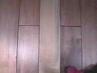

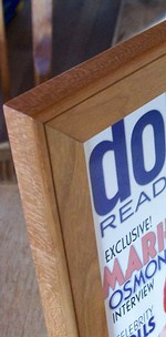

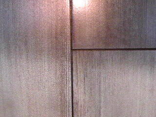

What kind of wood flooring?
« Reply #1 on: February 07, 2004, 03:09:33 PM »
Here are three different pictures of the same floor sample.The floor is t&g with a micro bevel, and stained and Varathaned.
The sample has two different stains and one strip natural.
Any guesses on the species?
There is no prize but I'm curious to hear what you all think. 8)

Alaska yellow cedar?

Re: What kind of wood flooring?
« Reply #4 on: February 07, 2004, 04:07:51 PM »
Beenthere & Tom,
It is a "hardwood" native to BC.I got the pieces off of the oldtimer that I bought the MD from.He had Q-sawed them on the mill and they have air dried for about 15 years.
They were in 2x8 form and we resawed them in his shop then run them through the Heaps.
I hope that there are more guesses because the first time I saw this type of wood finished,it really caught my eye.
I never even came close to guessing what it was. :)
« Reply #5 on: February 08, 2004, 08:11:04 AM »
Yes! You got it Lee.
It's Black Cottonwood (Populus balsamifera ssp trichocarpa)
and it grows west of the Rockies.
We are going to mill up some large butt logs when the snow leaves and see how it goes.The oldtimer told me that there was very little tension in the logs that he milled.
The one thing about sanding the floor sample was that it needed a light sand after the first coat of varathane.After that there was no fuzz problem.
But that was only a sample,the acid test will be when we run a whole floor.Glen,who put together the sample for me,wants to use it in a 20x40' youth room that him and his wife Lori are building.They want it as flooring,and panelling on one  wall.
« Reply #9 on: February 08, 2004, 02:47:39 PM »
I went and grabbed the knives off of the bench.They were ground for a 3/4" finished board.I had them made for a customer(Tom) that wanted to lay the floor down after pre sanding.
I was told by a few people that it wasn't the correct way to do things,that the floor is layed then sanded.Surprisingly it turned out OK.
On the ends of the boards,Tom used a block sander and gave each end a couple of quick sweeps to make a bevel.
