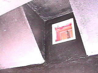

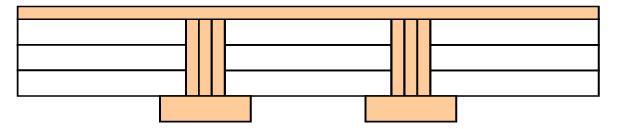

Woodchucker,
In essence my floor does sit directly on the ground, but my floor consists of 3 layers of 2" foam board, 1 layer of heavy plastic, 1 layer of 1" lumber, 1 layer of aluminum.  Directly under the track I put (embedded into the ground) treated 2x12's and fabricated  4 x 6 beams to support the weight. The lumber layer also helps by spreading the weight out over the entire floor.  I didn't like the idea of concrete floor, because of condensation, thermal conductivity and thermal flywheel effect.  Why heat up that much mass that you don't need to ??? ???
My thinking  about the moisure under the floor was that the heat in the kiln would dissapate any moisture.  Now, I am not so sure, I have noticed that snow will sit on the kiln for days while the kiln is at 150 degrees, long after it has melted from the rest of the structure.  In other words, the insulation works well. ;D I have not had any problems, but do not know what things are like under the floor.  Time will tell.  As far as the mice,  their dried up little bodies get swept out between loads. :(

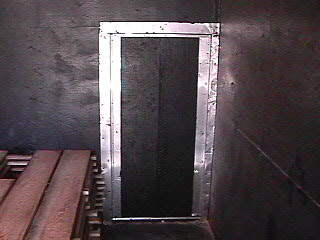

« Reply #10 on: September 13, 2003, 09:15:02 AM »
Sheet 3 of 13 shows a baffle ascross the top of the pile that the top of the L50 sticks through.  It would block an access door as shown for the L200, but, you could always put it on the other side of the pile.

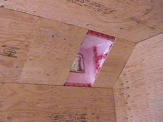

I think that foamboard would work just fine, as long as your top temperature doesn't exeed 160.  I made high limit 150 for safety sake.  Over 160 degrees and styrofoam foamboard starts to expand and lose its shape. If you are spending the big bucks for Polyisocyanurate then you can go right on up to 200 degrees. I couldn't afford it, so I keep my temp down.  I am probably running close to the top as far as my heat transfer would go. 150 degrees in the kiln out of 180 degree water.
The baffles I have hanging from the fan wall are a thin foamboard with skin on both sides.  The skin gives them the strength to  lay horizonally without too much bow.  Make some way to hold them up while loading and unloading.  I ran strings thru screw eyes that I can pull them up with.
