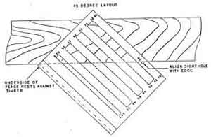

Re:Tools for Timber Framing=Using Layout tools
« Reply #2 on: June 04, 2004, 07:31:20 AM »
Using layout tools.
Before we begin talking about using layout tools, we have to understand some of the basic timber framing principals.
There are certain standards like all mortises have to be along the grain of a timber and not across the grain, because if it was across the grain it would obviously weaken the timber.
Another standard rule is that all timbers have to be flush with an adjoining timber on the outside face of the building, so that these joints don't push the siding away from any timber.
Above is a correct flush joint.
Above are two timbers joining with non flush joints. This is an incorrect layout.
Most timber framing companies use some sort of "square rule" joinery layout as apposed to scribe rule joinery layout.
Scribe rule means that each timber is custom fit to each other timber that it connects with. This is a very time consuming method of timber framing as one timber has to be aligned with each other timber it connects to, one at a time, and the joint locations are transferred from one timber to the other via a plumb line.

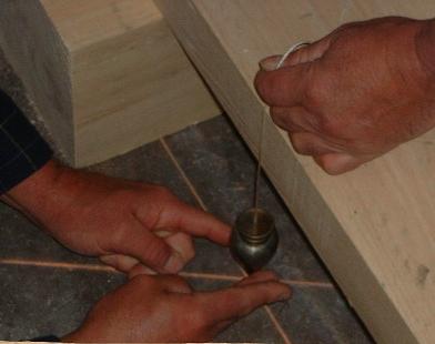

To use a plumb line to transfer lines from one timber to another, each timber has to be aligned over a full size pattern of the frame drawn on a stable surface usually the floor.
Drawing joints like this is very difficult and time consuming. And each timber can only be used in this scribed location.
To improve the efficiency of timber framing a new method was developed called square rule timber framing.
In square rule timber framing the timber framer envisions that there is a prefect timber inside each timber. And that this inner timber is true and straight with prefect edges and each face is truly 90° a to all other adjacent faces. This inner timber can be inside a hand hewed timber or a sawn timber.
Now that we have visualized that there is a true shaped inner timber inside an imperfect outer timber we slide this inner timber over to one face of the imperfect timber and therefore create a reference face.
As we are visually sliding this timber over to the face, we also slide it over so that one corner of this inner timber aligns with the best edge of this outer timber, creating a reference edge.
We do this by visually inspecting the timber.
We sight it for the crown and we align the timber so that the crown is in the correct position depending on where this timber will be in the finished frame.
You probably already know how to crown timbers, but if you don't you do this by sighting it from end to end.
After you have inspected it and determined the side with the crown in it, line the timber up on our saw horses so that the best face of the timber for appearance is on the inside of the building and the crown is in the correct position.
Align the timber so that any ugly faces are on the outside, whether it's an interior bent or a gable bent. With gable bents you have two faces that are not going to show and you can hide a lot of ugly stuff. If it's an interior bent and an interior post then all four sides might show and therefore you should pick your prettiest timber for this post.
More in next posting......

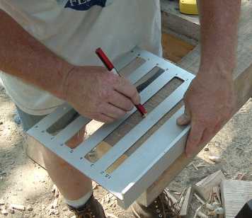

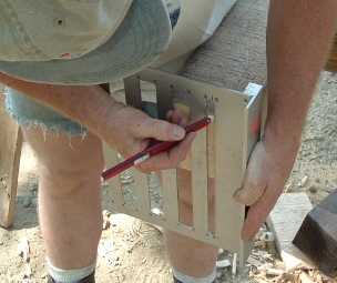

And you can now understand why you have to always hang or place your Big Al lay out tool so that the overhanging lip part is against the reference edge, like this:
I took this photo to show you what a Big Al looks like on a timber.
This way when you layout a tenon on the end of a beam that goes between two posts and the mortises on the two posts, are all laid out from the reference faces they will all line up and the joints in all timbers will be flush with each other.
More next posting........

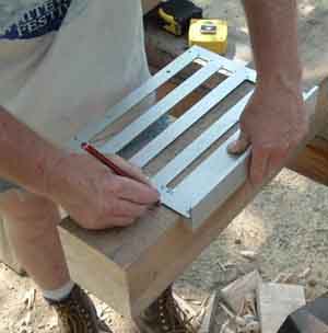

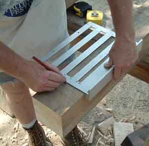

I use the Big Al more than I do a framing square as it has the hang-over-lip and sits on the timber without being held in place and is easier than using a framing square.
Before we begin drawing an end of timber cut line we need to further inspect the timber for the locations where the joinery will be cut to make sure there arent any big knots or defects in the timber right were these joints will be. What we do is to lay a measuring tape on the beam and lock it so that we can slide it from end to end as we need to in order to locate the areas where the joints will be made.
Next we refer to our drawing to determine how long the tenon will be on the end of this beam. In the case of this beam the tenon is to be 4 1/2 long from the end of the beam which is 131 long.
Now we can see where the shoulders of the tenon would be if we make this location the end of the timber. We also look at other joint locations along the timber and see where or if there are any knots at these joint locations. If we see that there is going to be knots where the joints are intended to be we can slide the tape down towards one end of the beam or the other until these intended joint locations are in an area where there arent any defects or knots.
Once we have determined that using this starting point on the timber will not place any future joint locations in an area where there are large defects or knots we can begin laying out the timber by drawing the end of timber cut line.
If you are going to draw a line all the way around a timber, such as a cut off line to make the over all length of timber, you first start at your reference edge. And draw your line across this face at the proper spot.
But before you move your Big Al from this spot you transfer the line around the corner onto the adjacent face using the hang over lip of the tool.
Then you hang the tool down the adjacent face without rolling the timber and mark the line down this side of the timber.
This would be the side that has the open triangle on it. Then after that line is drawn you would draw a line down the opposite side away from the open triangle side, but hang the tool down from the reference face (the one with the colored in triangle) this way you have drawn three lines referencing from the same face/edge, and they should be in line or in plane with each other.
Now for the last face you can roll your timber over (placing the adjacent face up) and place your Big Al on it from the adjacent face (open triangle face) toward other side and then draw the last line from the second line to the third line. If these lines, the second line and the third line don't line up then your timber is out of square. If your timber is out of square then you make the lines meet by connecting the end of the third line to the end of the second line. This way the post will be cut 90 to the reference edge.
So in that case don't make the fourth line with the Big Al until you see whether or not the lines truly line up, or you'll have to erase or plane off the incorrect line. If the lines dont line up then use another straight edge and connect the second line to the third line, so that when this line is cut the end will be 90 to the reference face and edge.

The timber in the picture above is a five by five inch timber that we’ll be laying out a four and one half inch long tenon on. The layout will be one and one half inches off the layout face and the tenon will be one and one half inches thick. The tenon will be reduced to four and one half inches in width to comply with our frame rule. That frame rule is that all timbers are sized down to the next one half inch in size, at the joint location.
Here is a drawing of what we will be creating:
Here it is labeled so we see what is what:
Now that we have our shoulder location marked and we have an understanding of what we want to layout, we can again begin with our Big Al layout tool.
First we mark the shoulder location on the reference face from the reference edge over to the one and one half inch slot:
Starting at the edge we draw a line over to the spot opposite the one and one half inch slot but not clean across the timber:
Then without moving the Big Al we pick up our pencil and start drawing the line again at the three inch slot:
And carry that line all the way over to the other edge.
Next, we slide the Big Al down and mark off the tenon lines at the one and one half slot:
And the three inch slot, making a tenon one and one half inches thick:

Using Layout Tools
Part 5 B
The next step is to bring these lines around the end of the timber:
And the other line:
Now we mark the tenon size on the four and one half slot:
At this point we have the top of the timber marked and the end of the timber marked.
Now we need to mark off the sides of the timber:
First we draw the shoulder line down the side from the top (reference face) to the bottom. Then we slide the Big Al over and mark the tenon size line across the bottom:
This size line is carried beyond the shoulder line to allow the timber to be reduced enough so that it wont be in the way of any part of the adjoining timber. We usually carry the line over one and one half to two inches beyond the shoulder. And then bevel that reduced face with a forty five degree cut.
And then we layout the other side:
First mark the shoulder line. And then the size reduction line:
Now we have three side of the timber laid out and we just need to roll it over and connect the reduction line across the bottom so that when its cut it will look like this:
The last step in laying out this tenon end is to score the lines with a knife:
We start the same way we drew the lines with the pencil and we score the lines with the knife. When scoring lines be sure to hold your metal straight edge on the timber correctly. And we score each line three times. Once very lightly, second time a little harder and the third time very deep. This scoring of the lines cuts the fibers of the timber and helps to prevent tear out when using a saw. Also, it creates an exact point, as the knife cut is absolute.

Tips on Using a Big Al for 45 angles.
Recently a fellow timber framer provided me with a instruction sheet on using the Big Al for making 45 lines.
Here is a shot of how it's done:
Basically, you place your Big Al layout tool on top of your timber and turn it until the "site" hole lines up with the edge of your timber. Simple enough.
