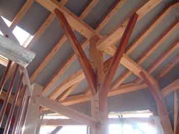

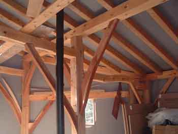

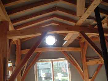

Here are some photos of this house and frame:

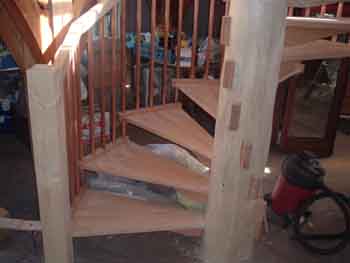

Above is a shot of the bottom of the spiral stair case.

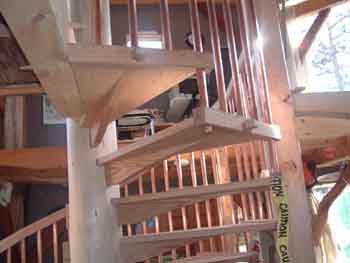

Below is the upper level of the same.
The tread supports are cut into the center wooden post and the balusters are copper pipe. The entire unit had just been installed it.

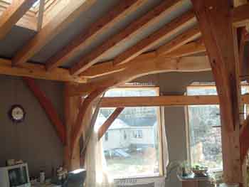

While I was there I helped them install a window on the second floor of this house.
This house was suppose to be 8 sided, but one corner didn't get made correctly to finish it out with 8 sides so it's really a seven sided house and frame.

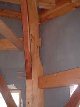

Here is a shot of a post from first floor:
Here is more:
Above is a shot of where two non 90 corners join. To make this easier to do the joinery and assemble they took a large post and cut it so that it had 5 sides and one side has the right angle so that the timbers could join this post with regular straight tenons.
At the top you can see where they cut away part of the post to allow the anchor beam tenon to come threw.

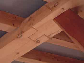

Knowing that the timbers are going to shrink, they accent the scarf joint by chamfering the edges where the two timbers meet. This was an interesting detail.

The accent line or shadow line did not show up to well in the picture.
How does it look in person?  Interesting. Thanks for the pics.

Ray:
Here is a close up of the joint:
Can you see the chamfer around the joint now?
The point about doing this is that the wood is going to shrink. The joint is going to open, by chamfering around the joint and accenting it, the gap doesn't look so bad when it opens.
And it is somewhat defused or disguised by the chamfer.
