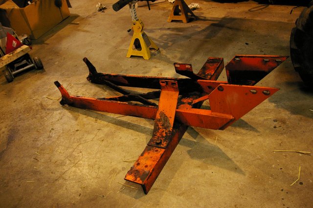

I recently acquired a B7100d Kubota and I would like to get a loader for it. They are very tough to find ao im curious if it would be worth it to build one. Has anyone ever made a homemade loader? Im guessing i would need to power it off the rear PTO? It does not have power steeribg but i am not looking to move anything real heavy, mainly off cuts and slabs.

« Reply #14 on: September 04, 2017, 05:59:27 PM »
http://www.orangetractortalks.com/forums/attachment.php?attachmentid=897&d=1261497261
This might give you ideas for the frame. (google search images)
There should be a way to tap into the tractors hydraulics to run the loader.
I have a loader on my 35 hp tractor and it is handier than a pocket on a shirt however making a frame for forks and a bucket for the rear would be a lot easier and carry more weight, with a trip release and/or hyd remotes and a hyd top link you can add a tilt function.
