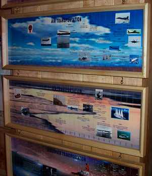

Got an e-mail from my youngest boy the other day asking me if I could make up some frames for him?
You see, he has a degree in computer drafting.  After working for various manufacturers and getting laid off because of economic downsizing, he decided to go back to college an get his teaching certificate to become a tech - ed teacher. One of the courses he is taking required him to develop a time line on the modes of transportation. He needed a frame to put each category in.
Here's what I came up with for him.  I had some basswood that was looking for a good use. I think it fit the bill pretty nicely as the frames hooked together are almost 5' long. The basswood, which I refer to as northern balsa wood kept the frames from being to heavy. A little shellac for a finish added some color to the wood, but didn't overpower the main reason for the frames, my boy's timelines.
Thanks for looking ;D

I like them. :)

Very nice Brian, did your son have a project too?  ;D

Yes he did. His project is enclosed in the frames and done very nicely, I might add   ;) :).

Did you clamp and glue those miters or brad them?

They are great,and it can't hurt his grades being presented like that either.

Tell your son that those pictures are real education in sequence.   From a retired educator.   Very nice work on posth of your parts.  thank yourselves for careing enought about kids to teach in such a creative maner.  Tht form of edcation is an everlasting technique of visul learning applied.

   As I went through the same course of study that your boy is now in I'd like to say that is one very nice time line for the transportation portion of the tech ed program.  Give him my best, hope he does well and lands a position with an organization as good as mine.
 Oh, by the way, NICE FRAMES!

Kevin,
I just glued and then clamped them with strap clamps overnite.  A trick I picked up somewhere's on gluing end grain, is to seal the end grain with glue first, then glue up the joint and clamp.  By sealing the end grain the glue is not wicked out of the joint and you'll have a very strong bond. Hopefully :).
