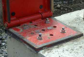

I recently went to a barn raising in VT. At this "hand" raising the posts were connected to the concrete foundation using a "hinge plate" this was something totaly new to me, and a lot of the other timber framers. And I'm not sure who designed it or if it was fabricated there at the school. But it worked great and seem quite easy to install.
Here are some shots of this "Hinge Plate"
Jim
I did not see them installed but it appears that the top half of the plate was attached to the post using a screw called a panel screw. These screws are used to connect structual insulated panels (sips) to frames. The base plate seems to have some type of tar paper under it and the bolts are secured to the concrete. These bolts had to be cut off using a grinder to allow enough clearance for the hinge to close.
Once the hinge was closed by the raising of the frame the whole hinge was repainted by a student of the school.
Some of these hinges were not connected together until the "bent" was being raised, this meant that the raising had to be stopped mid way up to allow the "hinge pin" to be slipped in, once the "hinge" halves were aligned. But that only took a few seconds and it went very smoothly.
I hope these photos can help some of you, to fab your own plates.

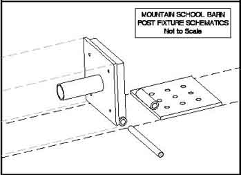

The designer of the hinge plate asked me to post a drawing of his design.
Also he told about this design on another timber framing forum, here is his posting:
Some clarification on the Vershire Mountain School hinged post bases. The panel screws from upper plate into post end grain are only locators. The real base-to-post connection is an inch and a half vertical pipe (1.9-in. o.d.) welded to the upper plate and inserted into a two inch diameter hole in post end grain. The pipe is, of course, invisible after installation.
In addition to horizontal restraint, this pipe can also provide hold-down capacity via a horizontal bolt/pin through posts and pipe. We did not bother with this in Vershire since structural analysis indicated that barn dead load exceeded predicted uplift by a safe margin (discounting any help from the vertical siding nailed to mudsills anchor bolted to the foundation).
Upper and lower hinge plates were welded together after the raising (the reason for the originally unpainted parts of the fixtures). Lower plates were bolted to the foundation with four three-eighth inch Hilti HVA adhesive anchors, two of which could easily handle side load or zero gravity uplift.
For future discussion there is a much more elegant prototype hinged post base on the drawing board waiting for an appropriate project. Ed Levin
Thanks to Ed for his help with the drawing.
