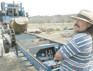

  This one is made with a 2x8 with a 1x3 backer and it has a 2x4 where my clamp is.  All were planed smooth and glued and screwed togther.  I tie my head to the axel and the blade is in a slot in the backer.  I just measure up from the deck by putting the blade down on the top of my "ARKY re-saw".  I just push the board through with another board and have some one on the other end catch them.  It goes pretty fast and works well.  If you need a hold down at the blade for the board just clamp a finger board on.
