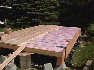

Nyle doesn't recommend fiberglass for insulation because it loses its R value if moisture gets into it.  I've used both and believe me the rigid ( I used blue Dow board) is far superior. If you're seriously considering running the kiln year round go with the rigid insulation!
I used 3/8" cdx plywood with 6 mil plastic vapor barrier between the plywood & insulation.  The plywood was attached to the studs with stainless screws.  In 13 yrs. I have coated the plywood twice with the mobile home tar.  It must do something as I have had no delaminations due to moisture.
The first coat was with the thin stuff,  the 2nd was with the porridge stuff.  I prefer the thin as it gets into the crevices better.

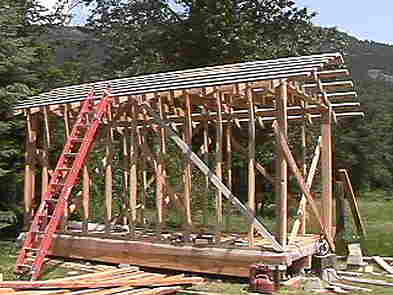

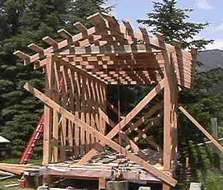

The kiln chamber is coming right along,but I don't think we will make June 11th :) Things are going well though and we will finish back framing and hopefully some wiring tomorrow.
The tin for the roof  will be here Monday.

Very nice looking work Paul, I like the way the floor is laid out. I should be up in the next few weeks. Will the kiln be done by then?

The kiln chamber has been coming along pretty well.But I can only work on it after work and on Saturdays,so it has slowed down.The roof is on,most of the exterior plywood,all insulated& polyed and sheeted inside.The unit is sitting in a box waiting to be installed,but first I have to put on the kiln coating.
I will have most of next week to work on it so it should be much closer to being up and running.I'll take some more pics and post them in a couple of days.
