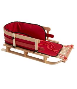

Hoping to build my grandson a sled ,hopefully before it snows.Found a picture of one which is built out of red oak and claims to be 10 lbs.This is what I would like to try to build.The only dry wood I have is walnut which was cut on a circular mill about 40 years ago and has been in my barn and is what I will use for everything but the runners. I have some hickory logs and some lumber.Was wondering if anyone has any ideas on how I could bend and dry green hickory to make runners and seat back.All the walnut will be hand planed .I've already planed some and it turned out pretty good.Want to make it as light as possible.Also any ideas on thickness of runners,can't really tell by picture

here is one from LL bean with a cushion.  over 250 bucks.
