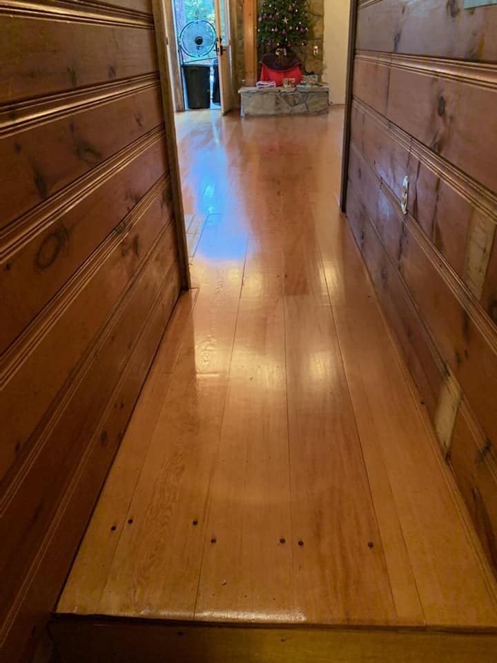

I had a customer that I did a bunch of reclaimed pine flooring for. His holes were a little smaller, 3/8"-1/2", but he drilled them out to a consistent size and then filled with a walnut dowel/plug glued in. The contrast came out amazing. I have a picture of it on the bragging board on my website.
 https://assets.zyrosite.com/m2WBonJRyzfQPp2w/finished-flooring-mP4PPQZZM5Tp77Mb.jpg
Edit: In looking at the picture, I'm not sure it was pine flooring. That's what I had in my head. This might have been the fir that a customer brought. It had been the bleachers in some gym. Made a beautiful floor but all the bubble gum was the devil to clean out of the planer.
