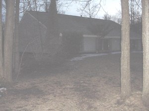

Burlman, Our foundation is wood. We live in an earthberm. The foundation is set on concrete footings. I can't help with the weight of the logs and such, but after 19 years we have no sighs of problems being buried half in the ground.

Our design called for pea gravel, but we have such sandy soil I was afraid of movement so went with the concrete.
I would think you need to let the site conditions dictate the specs for the foundation. I imagine you will have to, in light of today's building codes, anyway.
For instance, we are atop the highest hill anywhere around here, but we really float when the weather is really wet. Anything built here has to be on a substantial concrete foundation, or it will just sink into the ground. The problem here is a big vein of pipe clay, or Fuller's Earth, just below the surface. That stuff just refuses to let the water perk through, so it just flows along below the surface until it breaks out on top and forms a creek. It is pretty interesting geology, but a PITA for builders.
Have some borings done before you go too far with your plans.
