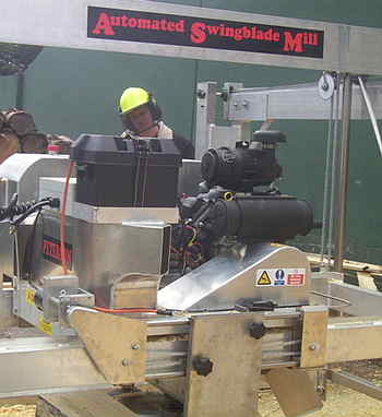

Ok, here are some photo's of the saw I bought from an  engineer at Woodmizer. He got it as part of a trade in deal:
Notice the extra tubing and bed rail on the front.
Same thing on the back.
I'm still debating on the idea of cutting away all the extra steel. What do the rest of you think ?
How do you like these stacks ?
Rick
I know what the guy must have been trying to do but putting something there that would tear up your knees doesn't seem to be worth it.  I would take it off too.
EZ
So what was the purprose with them. It looks like the bunks are only a few inches away from each other.
EZ
Bibbyman
Looks like they had it fixed up for some kind of outfeed tables or rollers.  I'd loose them if I couldn't figure out how to use them.
I put some exaust extentions on our Onan engine on our 94 LT40.  Just some conduit pipe. It cut down on the heat and exaust fumes.
Wood-Mizer LT40HDE25 Super 25hp 3ph with Command Control and Accuset.
Sawing since '94
D._Frederick
VA,
If you are going to saw trees that have stress in them, the add on bunks could be used to clamp your cants too when you are going to slice them up. Helps to have your lumber all the same thickness. The bunks are nicely made, so I would not be in a hurry torch them off.

VA-Sawyer
If you look close, you can see ( maybe ) that the extra bunks are not adjustable. They both slope downhill as you move away from the main tube.   If I need the support for long boards, I would be inclined to add 2 more of the "Pivot Bed Rails".
The only use I have had for the extra metal so far, was to tie on a couple of travel totes to carry all the extra parts he gave me when I brought home the saw.
One change I'm going to make tomorrow, is to wire a "nuetral safety switch" into the starter circuit. Almost had to change my shorts after it started with the blade engaged!!!
Rick
