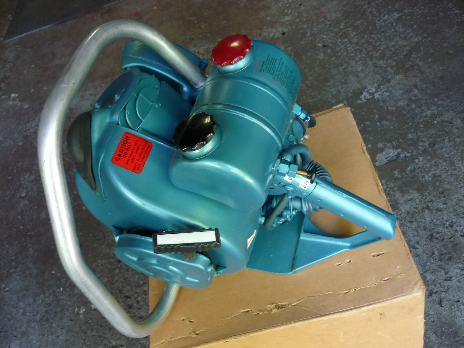

Anybody able to help ID this old girl? It has remnants of IEL stickers on it but I cannot figure out what model it is. Any input appreciated.

Normally Clinton's saws are yellow in color. This model D35 (pictured below) is blue in color since it was sold for European Export(serial number followed by letter E).
It could be sold to any company , so it did not come with decals. Also the muffler has a different shape to meet special requirements such as noise...on any export saws. The biggest importer of Clinton product was a French company named "Motostandard"...Sold without decals.
MANUFACTURED BY:CLINTON MACHINE COMPANY,CLINTON, MICHIGAN, U.S.A.
SERIES OR ASSEMBLY NUMBER: E
YEAR INTRODUCED:1959
ENGINE DISPLACEMENT: 5.78 cu. in. (94.7cc)
NUMBER OF CYLINDERS:1
CYLINDER BORE:2.125 in. (53.9mm)
PISTON STROKE:1.625 in. (41.27mm)
CYLINDER TYPE:Aluminum with cast iron liner
INTAKE METHOD:Reed valves
MANUFACTURER ADVERTISED H.P.:6
WEIGHT :22.25 lbs.
OPERATOR CONFIGURATION:One Man operation
HANDLEBAR SYSTEM:Rigid
CHAIN BRAKE:none
CLUTCH:Centrifugal
DRIVE TYPE:Direct
CONSTRUCTION:Die cast aluminum
MAGNETO TYPE:Clinton
CARBURETOR:Tillotson HC-11A
AIR FILTER SYSTEM:Wire screen
STARTER TYPE:Clinton automatic rewind
OIL PUMP:Manual
OPERATING RPM:4,500 to 4,800
IGNITION TIMING:33 to 35 degrees before TDC
BREAKER POINT SETTING:0.020 in. (0.5mm)
FLYWHEEL/COIL AIR GAP:0.007 to 0.017 in.
SPARK PLUG TYPE:Champion J8J
SPARK PLUG GAP:0.028 in. to 0.033 in. (0.7mm to 0.8mm)
CRANKSHAFT MAIN BEARINGS:Ball on clutch end, needle roller on flywheel end
FUEL TANK CAPACITY:1 U.S. Quart
FUEL OIL RATIO:3/4 pint to 1 U.S. gallon for break in of 5 hours then
1/2 pint to 1 U.S. gallon
RECOMMENDED FUEL OCTANE:Regular
MIX OIL SPECIFICATION:SAE 30 MM or MS motor oil, or outboard mix oil
CHAIN PITCH:.404 in., .058"
CHAIN TYPE:"Superjet"
SHORTEST GUIDE BAR SUPPLIED:14 in. (35 cm)
LONGEST GUIDE BAR SUPPLIED:26 in. (66 cm)
COLOR SCHEME:Clinton Blue Enamel.
D30 and below that, a D35, suspect the D30 is closer to yours I suspect.

THANK YOU!! This is the only saw in the 60 saw lot I have not been able to identify. I was walking down the wrong road with IEL as the make. Can't figure out what the remnants of their sticker is on there for. Maybe they bought some to brand and sell, who knows?
With your Clinton D35 I plugged that into google and it came with this photo and a couple other variants of it like yours are. My saw is just like the one in the photo. Thanks again, Much appreciated! Amazing what a bit of correct information can accomplish :laugh:.
