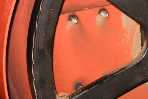

On the Wood-Mizer mill,  there is this plate about 5x6" that covers a cutout on the idler side of the blade housing.  Bless Wood-Mizer's heart,  they used 6 5/16x3/4" long plated hex bolts and nuts with locking inserts.  Quality stuff.  The plate itself looks to be 1/8" thick.  Plenty strong.
"As built" outside
"As built" inside
The problem is,  they assembled everything on the wrong side.  See...  The plate, nuts and excess bolt length is sticking inside the blade housing.  Ever struggle getting a broken blade out from behind one or more of these bolts sticking out?
I replaced the hex head bolts with button headed cap screws 5/16x1/2".  I replaced the plate on the outside and put the button heads on the inside.  That should make broken blade removal a little bet easier I'm a'thinking.
Changed plate to outside of housing.
"Inside of housing showing button head bolts.
The button head bolts were not exactly what I was looking for.  Plain pan head plated bolts 5/8" long would have worked better.  A gripping type flat head bolt would have worked even better.  But this is what I found at Westlakes.  Even using the existing hex head bolts and turning them around and moving the plate to the outside would achieve quite a bit of extra clearance.

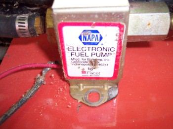

I put an electric 12 volt  fuel pump in line for priming the 42 hp diesel engine when i change fuel filters or run it out of fuel.Pumping the manual leaver on the engine mounted fuel pump just dont get the job done.
Bibbyman
Good tip Stump Jumper,
Got any more details?
Like what kind of pump did you used - brand part number?
How did you hook it it the line and wire it up?
Got any pictures?

Stump Jumper
Got some pictures today hope this will explain things a little more for ya's.
This picture shows a Napa fuel pump.  Sorry don't know a part number.  I salvaged it off an old pick up.
You can see that I don't have hose clamps on yet as it was a temporary test installation.
The fuel pump is mounted right under the fuel tank to an existing back panel bolt.
I ran jumper wires from the power terminals in the sylenoid box.
I open up the bleeder screws at the filters and run it until they get fuel.  Close the bleeder screws on the filters and open the bleeder screws on the injection pump until they get fuel.  Close the bleeder screws and I start the engine with the electronic fuel pump still running for a few minutes.  Then I shut it off  disconnect the fuel pump wires and we are good to go.  The engine fuel pump will now suck fuel through the electric fuel pump with no problems.  I suppose I ought to put some hose clamps on and wire a fuse and switch in.

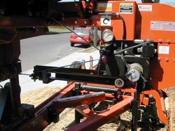

Ok, here is a mod that might be more useful to the WM walkers.
It's a platform to stand on as the sawhead moves throught the cut.
It bolts to the lower cam follower mounts and goes under the battery box.
It's hard to see, but the bottom of the platform is 5" off the floor. This way you can walk if you want. Also, you won't hook your toes when walking past.

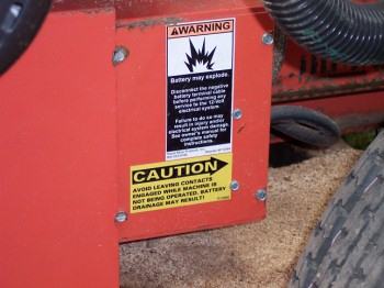

One easy thing to do is add lights to the mill trailer.  All the lights are for the benefit of the following traffic.  If you put a drop off of your running lights to a small indicator light, or even white, downturned spotlight, next to the tires,  you can see where they are when you are turning a tight corner at night.  A small indicator on either side of the head of the mill and a couple on the top of the head Posts will help you feel more comfortable too.  Just some little lights to help you determine where everything is at night. :)
