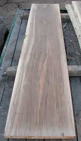

Hmm . . . Sweetgum . . .
That's 12' and 6/4. The heartwood (Redgum) is the only good part. :)

Urban logger that looks like the sweet gum i had one time.
some of it spalted and i used it in a segmented turning.
I sure do like and if the tree service git some logs will have
some more.
