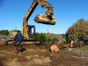

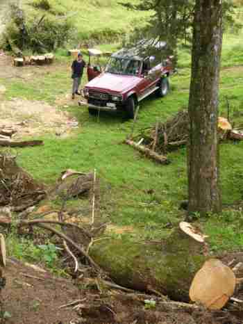

Hi Bill
I use whatever I can get my hands on to move logs  :D
With a bit of luck I can just drop the tree and mill it where it lays.. but usually it's someplace awkward so,
or
Bulldozers, tractors and quad bikes have all been pushed into service at times, and as a last resort there is allways the trusty cant hook .
Cheers
ex-Engineer Wannabe
Really nice photos, Ian! :)
Is that a winch you're using on the front of that 4x4?  I imagine it is because that duty would be mighty tough on the drivetrain.  My 4x4  weighs almost 9000 lbs, with a Cummins Turbo Diesel, and I would't try that one.  :D
