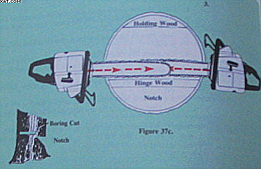

QuoteFirst you cut the "pie" as we call it down here I guess the "scarf' is the proper temrinology. Then you insert a plunge cut on the opposite side of the scarf, leaving a few inches of holding wood on the backside, and pushing the blade to exit out of the scarf?
How does the blade keep from getting pinched as it approaches the scarf?
Sorta... on the main backcut the bar doesn't exit the wood at all. You still leave normal hinge wood behind the scarf. So at that point the tree is still supported by the hinge (about 4" in this size tree) and the back is held down by the strap at the back (about 6" wide)
Quotethen the final cut on theholding wood on the backside? With all that tension on this "holding wood" as I'm calling it, i bet just a touch from the blade will snap it right away?
Yup... the holding strap at the back is under a LOT of tension. But it's a simple cut to release it, then get the heck out of the way  :D Once you cut that, the tree starts moving right away.
The advantage of this method is that you pretty much remove the chance of a barberchair , which is the main worry in leaning trees. It gives you the chance to set up your hinge wood  properly, before the tree thinks about falling. Then do one small cut from about the safest possible place and over she goes.
I have put some notes on the stump picture, hopefully that explains better.
These are Leewee's pictures from the post he refered to, they explain the theory better.
