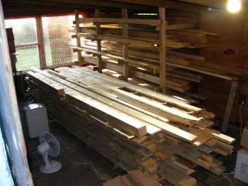

This is my air / solar / dehumidifier setup in the back shed.
Works well in summer but a bit slow during the winter and the d/h unit ices up under about 10C
I wouldn't like to be drying tons of timber with this lowtech aproach, but with the pine and assorted cypress I've been sawing it's working good
Since that picture was taken another stack of Monteray cypress has been loaded in there too :)
ian

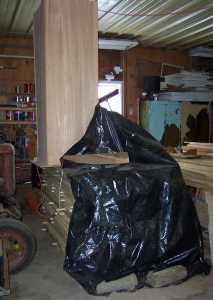

I also have a low-tech kiln,  well insulated 12' X 25' attic space with two electric heaters, dehumidifier, and a 20' fan.
I air dry for 3-4 months (pine) then bring 400 - 500 fbm per load. Wood moisture content drops down from 12% - 16% to 6% in four or five days depending on outside humidity.
I don't turn on the dehumidifier until the room temp hits 70F or so.
Does anyone know where I can get a good electric heater,  I got one 220 volt and one 110 volt but I can only get the attic temps up to 90F it's not quite enough.  What do they use in like the Nyle for supplemental heat.

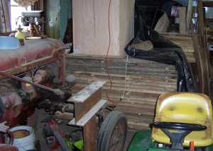

Bill is that a Farm-all A cause I got one ??
Offline Bill_B
  • Full Member
  • Posts: 86
  • Location: Rio Wisconsin
  • Rio Wisconsin
Re: Drying in wood shop
« Reply #8 on: February 13, 2004, 02:44:46 PM »
Termite. Yes if is a Farmall A. It is one that my Dad used.
I have dried mostly hardwood.
Oak,  Hard-Maple, Elm and Hickory.
Bill B
