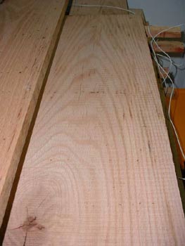

This is some paneling I did in my living room that came from standing dead pine. There is a lot of bark beetle infestation around here. I try to take advantage of it when I can.
