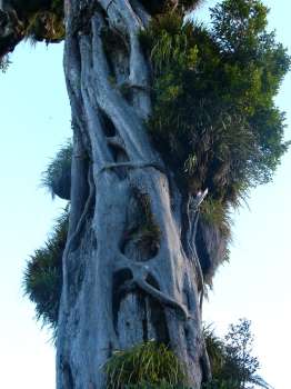

I dont know much about climbing, but when you epiphytes get to this stage... start thinking about logging the vines  :D
Rata vine growing on a Rimu tree, Egmont National Park NZ

Sounds like a similar thing
The rata vine grows from windborne seeds in the tops of the old rimu. Roots reach down to the ground , wether the rimu dies of strangulation  or old age is debatable, but the rata vine can live on for 100s of years after the host tree is gone.
As you can imagine the rata wood is one of the toughest timbers around, green it is heavier than water, but is a real neat red/ purple colour
