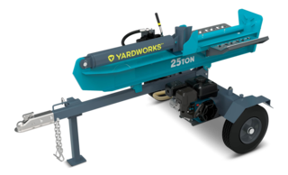

I need to draw on your hydraulic expertise in diagnosing a problem with my splitter.
I was out splitting tonight and starting the last split actuating the valve forward and the ram took off like a shot about halfway. I jumped and let go of the lever.  Then pulled it again and it shot out the rest of the way and then stalled the engine.  I started it back up and tried to reverse the ram but it still wanted to go forward at lightning speed and stalled the engine out again.
I m only speculating but I figure the problem is with a broken seal in the control valve... does this sound right?
I figure the cylinder would likely not move if it was an internal seal but i honestly dont know.
Any ideas would be great...Also it's been a while since I have posted...glad the forum is still going :), thanks.

Most likely the piston seals are blown on your cylinder.When the seals are blown the rod will go out no matter which port oil goes in because piston side of cylinder has the most surface area.It could also be that the nut has came off of end of rod letting piston come off.Would do the same thing.To check and make sure unhook both lines at cylinder and with rod all the way out blow air in port on piston side and if air comes out other port tear cylinder apart.

Either the nut came off the end of the rod and the piston is floating free in the cylinder or the piston seal has given way.  There is no counterforce to regulate the speed of the cylinder extending and also no way to retract the cylinder.
You can confirm this by the following:
With the engine off, you can push the rod back into the cylinder. You may have to hold the lever open.
Start the engine and move the lever to the retract setting.
If the piston is not attached to the rod or the seal is broken, the entire cylinder will pressurize instead of just one side and the rod will extend.
You can probably find a replacement at surpluscenter.com easily.

I did as you detailed.. reset the rod and started up the engine on low idle, moved the valve in to retract position and the cylinder went forward then tried the forward position and still went forward...so i guess the rod must not be attached.  I am going to check with the local machine shop to see what it might cost to fix.  Thanks, i'll be back with more details.

The splitter is from Canadian Tire here in Canada.. the ugly teal green and all.
I brought the cylinder to my local shop this morning and the fella threw it up on the healing bench and pulled the rod right out...the nut had come off...you guys were right.
Thank you kindly for the help..its good to add this experience to my bag of knowledge.  I will report back with how the fix went.

I picked up the cylinder last night all fixed.  They reattached the rod to the piston and replaced a couple seals.  I re-installed on the splitter topped up the fluid and everything is back to normal.
Thanks again for all the help. Much appreciated.  I hope this thread can help someone in the future that has limited knowledge like myself.
